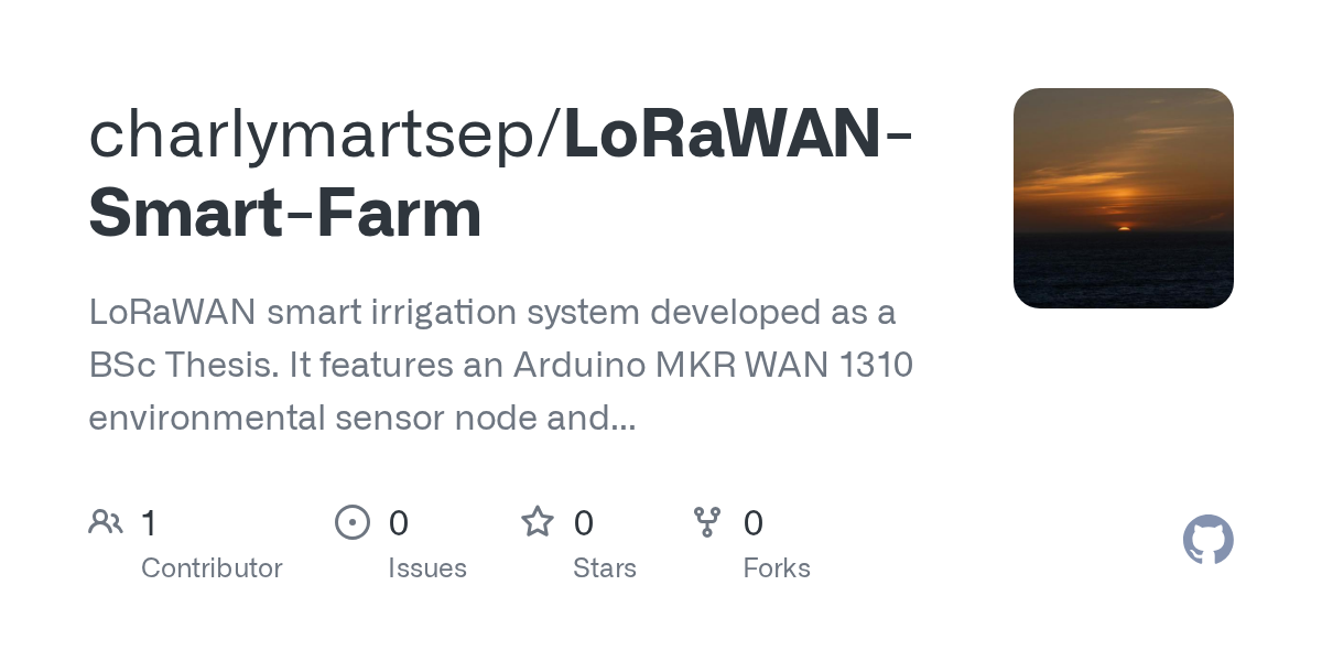

I have published the entire C++ firmware, Node.js backend, and the Grafana Dashboard (JSON export) on GitHub so anyone can dive into the details:
