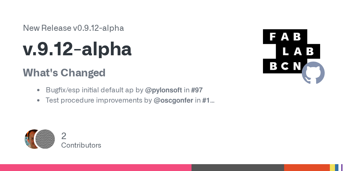

So, we are working on a branch with some fixes for this issue at the moment, and I’d love to see if someone can do some alpha testing with me… Anyone interested DM me. I’ll also share here the branch once it’s ready…
Thank you so much!
I anyone is interested @miasma @smartcitizen.both498, the branch is currently under testing on our side. Would love to have your feedback:
Hey there, and apols for delayed response - happy to test this out. How to download (my GitHub skills are poor)
Hi @miasma
Thank you for the offer! I have just regenerated an alpha release for testing:
You can download the files there and upgrade both, ESP and SAM firmware as usual:
https://docs.smartcitizen.me/guides/firmware/upgrading-the-firmware/
Let us know! If you want more direct talk, I am oscgonfer at discord as well.
