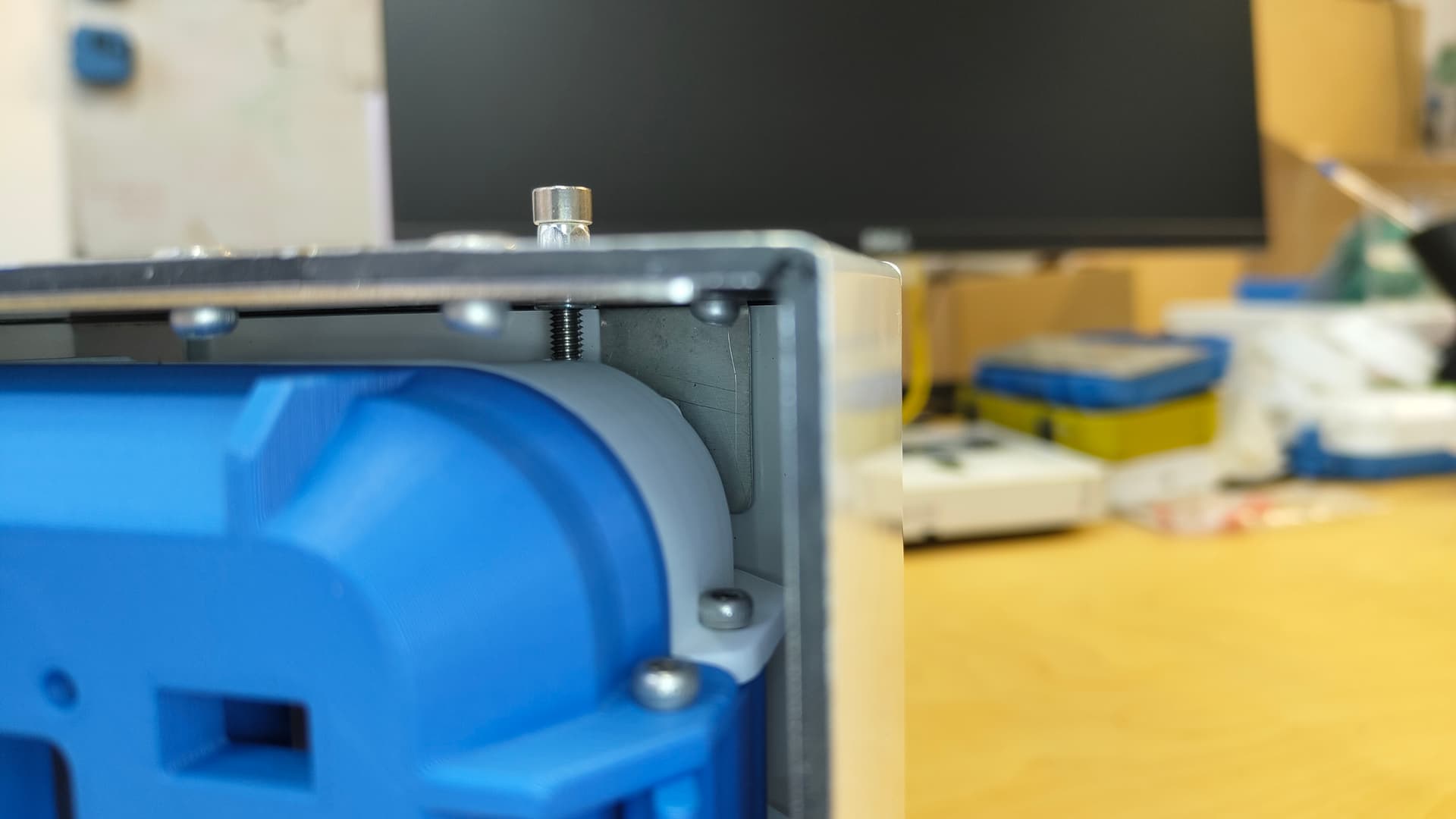

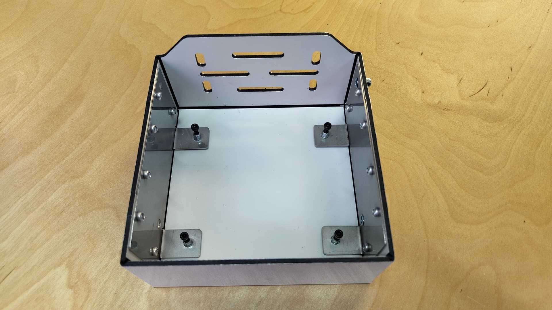

Once you have the umbrella eready with the pletinas on it you have to put some M3*20mm screws on the threaded inserts like so:
This is where the cover of the kit i going to gold.

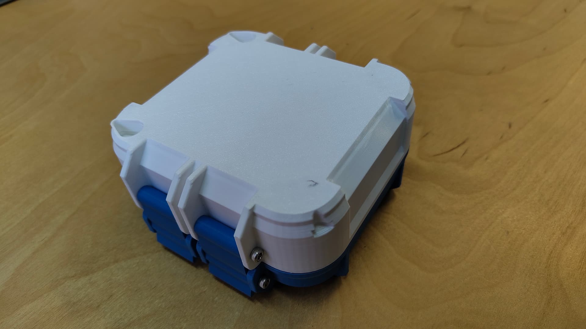

Make ure you have printed the correct cover: Outdoor Small cover. you’ll see four mounting points that will align with this four M3*20mm screws.

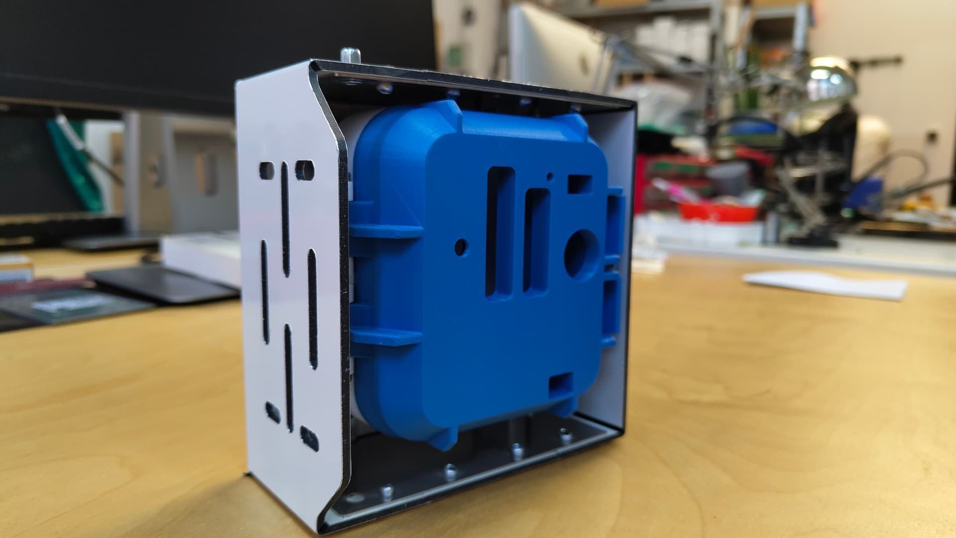

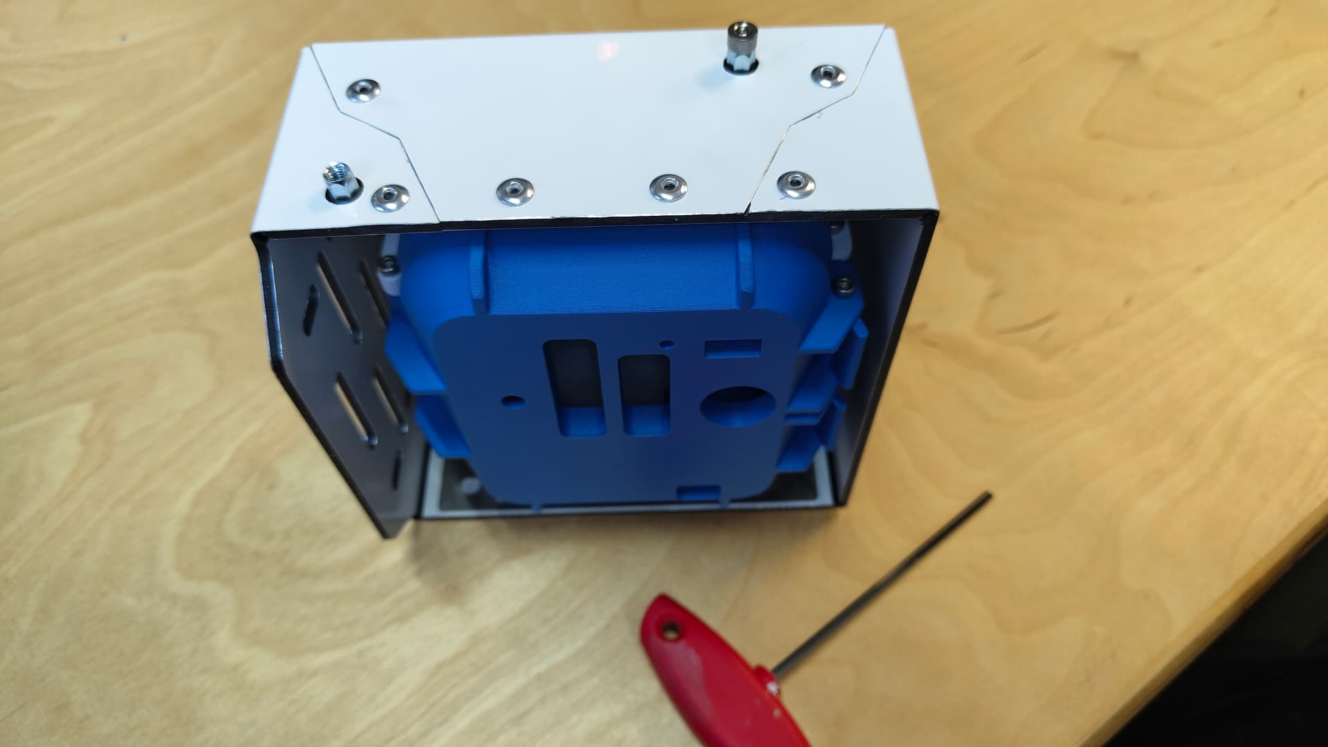

Once you have the correct elements you can put those together, make sure the back part of the Umbrella and the hinge of the enclosure are on the same side. Place the big openings on top of the screws and slide gently down, this will place the other two screws in place and fix the enclosure to the Umbrella.
To make sure this is not going to move, you will need an M4 screw to fix everything. From outside enter the screw to the threaded insert (the one that is closer to the “outer shell”, this will press the enclosure fixing it in place. This M4 screws are also used to fix an outdoor power supply. Here more information.
