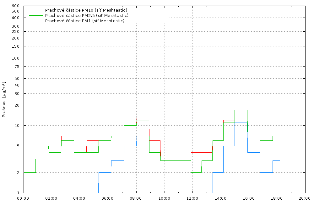

yes, PMS5003 sensor, fresh data:
Actually I’m not sure that node with the PM sensor will live all the winter even with 20W PV.
As MCU the Nordic nRF52850 is used (in module RAK4631).
