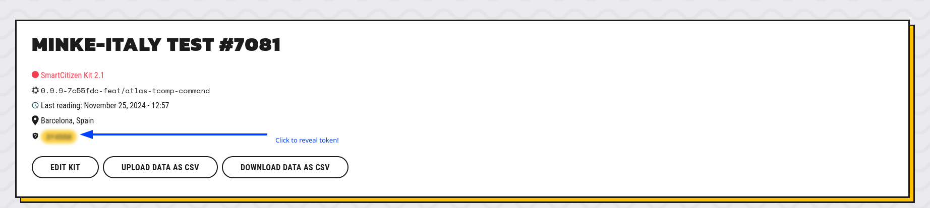

The link you refer to is for the “legacy” hardware (V1.*), but I assume you are using a SCK2.1 or 2.3?
As far as the use case you need, this would be fairly straight forward if you use a SCK2.*. The device token you get from the onboarding page can be found in the kit page (as an example):
You don’t need to write it down, but simply remember that it’s there. Now, if you create a new “demo” device via the onboarding page, you will get another token. This token will now be used to match the data coming from your device to the “demo” device, and it will “pause” the readings on the original “home” device. Once you are done with the demo, you can put the “home” token back onto the device. Here you have a guide on how to do it: Updating the SCK token - Smart Citizen Docs

Gotcha, thanks! What lost me is that the token couldn’t be found on the profile’s kits but only on the “platform” UI. Kinda disturbing choice if you think about it.

Hey folks! Aha, good catch about the token being missing from the profile kits pages - I missed that on the old platform during the redesign - I will add it to the new kit UI ASAP. Thank you @AVB!
