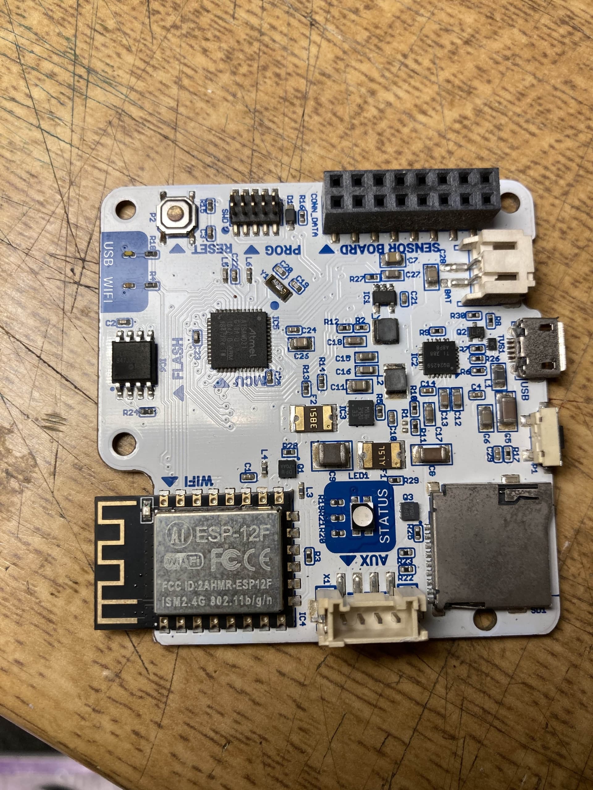

We have a SCK2.1 that has been running well for 5 years, but dropped out back in April 2025:
https://api.smartcitizen.me/ui/devices/13114#
When we looked at it, it had a solid blue light, so we did a soft reset (power cycle). It then had a breathing blue light, but still not posting data.
Finally got round to looking at it - I have tried a soft reset, updating the firmware (to SAM_firmware_sck2.uf2) and a factory reset. I occasionally in that process was able to connect to the local access point, but generally it would not appear.
I then connected via serial monitor in Arduino IDE, and saw that the board was repeatedly saying:
Restarting ESP...
ESP off...
ESP on...
So then the next time it happened to get the ESP to start, I tried updating the ESP firmware via the Local Access Point page.
This has not worked - the board is still repeatedly turning the ESP off and on again, and has not yet been able to get the ESP to start at all.
Do we have a faulty ESP? If so, should I simply solder on a replacement?

Are there any signs of ā€œcorrosionā€ on the ESP, something like blue residue or similar?

No corrosion / blue residue that I can see…

Yes, the ESP, and the board in general, looks perfect. The firmware is the same, no matter of you have sensors on the AUX port, no worries. Also, the folder structure seems well set, don’t worry about the firmware directory either.

Thanks to @oscgonfer and a new SCK2.1 data board, this is now fixed - I presume it was a faulty ESP.
