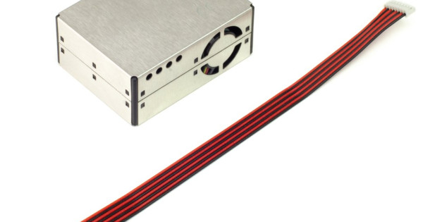

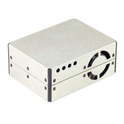

seems like that sensor is providing wrong readings. Probably there is something in front of the laser (or the light detector) that is making this spurious readings. I would suggest to replace the PMS5003 sensor as its fairly inexpensive, and try to clean the removed sensor with compressed air or similar, checking if it improves.
Hi Óscar,
Thanks for the recommendations. We’ve decided to replace the PMS5003 sensor. I found many providers online, even an option for about 14 EUR on AliExpress. Would any of these work, or may I ask if you have any recommendations on where we should order these here in Europe?

Hi,
Other providers in Europe could potentially help you save some issues with purchases from Aliexpress. Some recommendations:
https://eu.mouser.com/ProductDetail/Adafruit/3686?qs=rrS6PyfT74ekfI0ilCENKA%3D%3D
Best
Hi Óscar,
Great, thanks for the recommendations. We’ll go for Nettigo this time.
